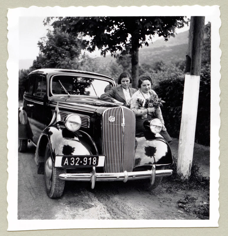

I see. Thank you.
I meant only the 4-door sedans.
Regarding the old pictires with a round badge see the attachment.
The photo taken circa 1937 (c) Raymondx1
Best wishes, George

Re: Opel 6 (oder Super 6...) | Unterscheidungsmerkmale
Claus, to turn the discussion into a more practical direction: am I right thinking that OCE Opel Super 6 could be converted to the Opel 6 relatively easy? All we need is to replace the front grille, wheel hubs, and correct the air inlets?
Best wishes, George
Best wishes, George
Zuletzt geändert von Opelmeister am Mi 6. Apr 2016, 14:53, insgesamt 1-mal geändert.
OK, You have to change the grille anyhow. The late Opel 6 have the same rims with holes as the early Super 6, with the same bigger hubs. If You modify the horizontal air-inlets to a smaller row, You have to use rims without holes and with smaller hubs. Otherwise: If You make vertikal air-inlets, You can use the original wheels of the model.
